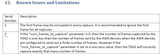

  • 1.采集的ADC数据存在丢帧问题,配置采集100帧数据,但是实际只采集到83帧数据,请问该如何解决?
    请参考mmwave_studio_cascade_user_guide.pdf里,下面第二条known issue

  • 您好!我可能对丢帧问题描述不太清楚,正如If the “num_frames_to_capture” parameter is 0, then the number of frames captured by the
    TDA2 is one less than the number of frames sent by the AWR devices when the AWR devices
    are configured to send out a finite number of frames描述一样,当帧周期时间很长时,只会丢一帧,但是当帧周期较短时,DutyCycle超过50%时,会发生丢很多帧的情况,请问该如何解决?
