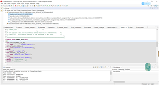

我是用的lab是:C:\ti\mmwave_automotive_toolbox_3_6_0\labs\lab0002_short_range_radar
我在DEBUG的时候consolo弹出一下窗口[Cortex_R4_0] Exception occurred in ThreadType_Main.
Main handle: 0x0.
Main stack base: 0x8009f00.
Main stack size: 0x1000.
R0 = 0x00000000 R8 = 0x00000001
R1 = 0x00012707 R9 = 0x0000ecbc
R2 = 0x08000009 R10 = 0x126a0000
R3 = 0x08008d5c R11 = 0x000000d1
R4 = 0x08008d94 R12 = 0x000105a9
R5 = 0x00000001 SP(R13) = 0x0800af00
R6 = 0x0800bee2 LR(R14) = 0x0000ed18
R7 = 0x0800bed0 PC(R15) = 0x0000ecbc
PSR = 0x400c01df
DFSR = 0x00000000 IFSR = 0x00000000
DFAR = 0x00000000 IFAR = 0x00000000
ti.sysbios.family.arm.exc.Exception: line 209: E_undefinedInstruction: pc = 0x0000ecbc, lr = 0x0000ed18.
xdc.runtime.Error.raise: terminating execution
我上传了我烧写的XER4F文件,请问这是为什么呢?

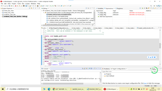

  • 代码我不可以直接发送给您,我尝试了其他工程,发现也有此问题,一旦载入xwr16xx_mmw_mss.xer4f就会弹出以下提示
    consolo提示为
    Main handle: 0x0.
    Main stack base: 0x800c1a0.
    R0 = 0x00000000 R8 = 0x00017580
    R1 = 0x00000000 R9 = 0xfffffffe
    R2 = 0x00000018 R10 = 0x0800aeec
    R3 = 0xfffffff1 R11 = 0x00000000
    R4 = 0x0800aeec R12 = 0x00000000
    R5 = 0x00000045 SP(R13) = 0x0800d1a0
    R6 = 0x00000000 LR(R14) = 0x00010e08
    R7 = 0x00003e62 PC(R15) = 0x00010dac
    PSR = 0x400c019f
    DFSR = 0x0000000d IFSR = 0x00000000
    DFAR = 0x080f25e8 IFAR = 0x00000000
    ti.sysbios.family.arm.exc.Exception: line 209: E_undefinedInstruction: pc = 0x00010dac, lr = 0x00010e08.
    这个问题我无法解决,请帮助我一下
