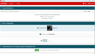

How to download programs to 2944,use uniflash? (uniflash 7.1.0)
请下载下面的SDK, 烧写工具在C:\ti\mmwave_mcuplus_sdk_04_02_00_02\mcu_plus_sdk_awr294x_08_01_01_06\tools\boot
https://www.ti.com/tool/download/MMWAVE-MCUPLUS-SDK
具体烧写文档,请参考C:/ti/mmwave_mcuplus_sdk_04_02_00_02/mcu_plus_sdk_awr294x_08_01_01_06/docs/api_guide_awr294x/TOOLS_FLASH.html
