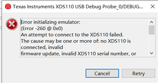

question: 2944 ccs debug:
Click debug:
error:
No need to download awr2944_ccsdebug.appimage to AWR2944 EVM Rev.001,when ccs debug?
download ccddebug, use uniflash .

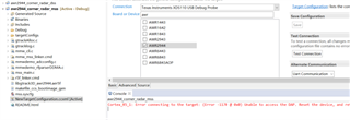

Click debug:
error:
需要烧写awr2944_ccsdebug.appimage,同时需要确认仿真器端口已经被识别,test connection能通过吗?
