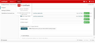

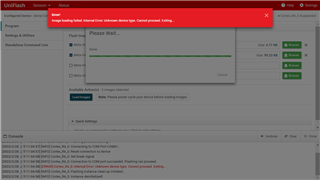

awr2243的sop2可以把固件下到内存,这个可以跑通。但是sop5不能下flash,主要是uniflash检查版本不通过,你问问有没有解决方法?
!!!需要您帮忙看一下 用这样的方式行不行!!!

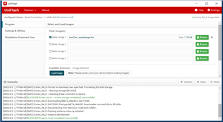

把器件设置成awr1642,可以下awr2243的固件。把器件选成awr2243,不能下awr2243的固件。
[2022/3/3 上午9:06:40] [INFO] Cortex_R4_0: Initialization complete.
[2022/3/3 上午9:06:40] [INFO] Cortex_R4_0: Flashing process starting...
[2022/3/3 上午9:06:40] [INFO] Cortex_R4_0: Connecting to COM Port COM61...
[2022/3/3 上午9:06:40] [INFO] Cortex_R4_0: Reset connection to device
[2022/3/3 上午9:06:40] [INFO] Cortex_R4_0: Set break signal
[2022/3/3 上午9:06:40] [INFO] Cortex_R4_0: Connection to COM port succeeded. Flashing can proceed.
[2022/3/3 上午9:06:40] [INFO] Cortex_R4_0: Reading device version info...
[2022/3/3 上午9:06:40] [INFO] Cortex_R4_0: ** 1 files specified for flashing.
[2022/3/3 上午9:06:40] [INFO] Cortex_R4_0: Checking file C:/ti/mmwave_dfp_02_02_03_01/firmware/xwr22xx_metaImage.bin for correct header for AWR1642.
[2022/3/3 上午9:06:40] [INFO] Cortex_R4_0: AWR1642 device, fileType=META_IMAGE1 detected -> OK
[2022/3/3 上午9:06:40] [INFO] Cortex_R4_0: !! Files are valid for AWR1642.
[2022/3/3 上午9:06:40] [INFO] Cortex_R4_0: Format on download was specified. Formatting SFLASH storage...
[2022/3/3 上午9:06:40] [INFO] Cortex_R4_0: -->Erasing storage [SFLASH]
[2022/3/3 上午9:06:40] [INFO] Cortex_R4_0: -->Sending Erase command to device...
[2022/3/3 上午9:06:53] [SUCCESS] Cortex_R4_0: -->Erase storage completed successfully!
[2022/3/3 上午9:06:53] [INFO] Cortex_R4_0: Downloading [META_IMAGE1] size [7940]
[2022/3/3 上午9:06:54] [INFO] Cortex_R4_0: SUCCESS!! File type META_IMAGE1 downloaded successfully to SFLASH.
[2022/3/3 上午9:06:54] [INFO] Cortex_R4_0: Disconnecting from device on COM port COM61...
[2022/3/3 上午9:06:54] [INFO] Cortex_R4_0: Flashing instance clean-up initiated...
[2022/3/3 上午9:06:54] [INFO] Cortex_R4_0: Instance deinitialized!
[2022/3/3 上午9:06:54] [SUCCESS] Program Load completed successfully.
这个是LOG,不知道能用不能用,反正下载成功了
