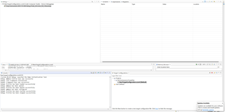

目前我采用iwr1443单板尝试采集一帧ADC信号,在iwr1443中刷写了mmwave_sdk_02_01_00_04\packages\ti\utils\ccsdebug\xwr14xx_ccsdebug.bin ,并在ccs中load了F:\ti\mmwave_sdk_02_01_00_04\packages\ti\drivers\test\mem_capture\xwr14xx\xwr14xx_mem_capture_mss.xer4f。运行后console显示如下内容,
[Cortex_R4_0] Debug: Launched the Demo Initialization Task
Debug: mmWave Control Sync was successful
Debug: Test Framework Initialized
Debug: Framework Sync was successful
Debug: Profile has been loaded successfully
Debug: mmWave has been opened
Debug: Profile has been opened successfully
Debug: mmWave has been configured
Debug: Profile has been started successfully
Debug: Profile has been stopped successfully
请问后续我该如何操作?
