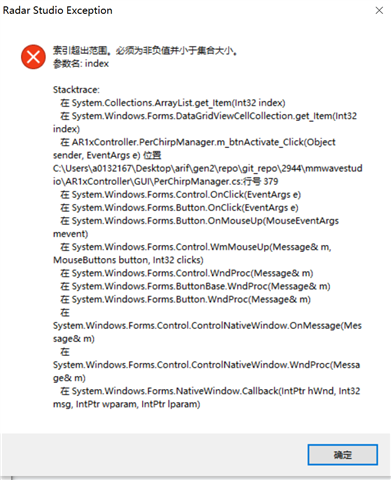

,mmwave studio 如何解决这个错误。
目前mmwave studio不支持AWR2944,是用Mmwave Studio CLI tool,将会在TI resource explorer网站更新,请关注下面的网站。
https://dev.ti.com/tirex/explore/node?node=AD9z.2Ydz0RjPF.ZURidPg__Z2F8GEn__LATEST
另外,可以参考下面帖子的讨论。
https://e2e.ti.com/support/sensors-group/sensors/f/sensors-forum/1062218/awr2944-what-is-the-mmwave-studio-version-supporting-awr2944
https://e2e.ti.com/support/sensors-group/sensors/f/sensors-forum/1063218/awr2944evm-capture-raw-adc-data-with-awr2944evm-and-dca1000-by-using-studio-cli/3934290
