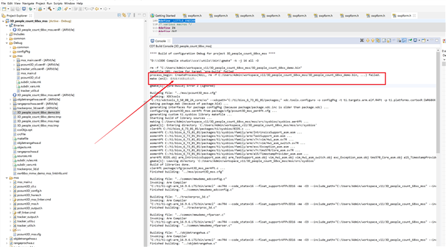

如题。
如果没有其他build error,能生成bin文件的话,这个pre-build的提示可以忽略。请看下面帖子的回复。
The pre-build failures are harmless as they are just warnings that the build system was not able to delete pre-existing .bin files in the directory.
https://e2e.ti.com/support/sensors-group/sensors/f/sensors-forum/778450/ccs-iwr1642boost-post-build-failed
