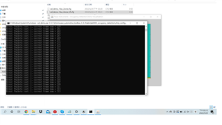

你好:
  我使用Toolbox 3.0.0,我正嘗試修改Occupancy and Vital Sign Detection 的偵測區域,當我在進行Coefficent Tuning的動作時,我參考的是occupancy_detection提供的作法(因為Occupancy and Vital Sign Detection的User Guide裡寫的作法並不詳細,而且並沒有提供工具),但最後調整完的偵測結果並不好。所以想確認Occupancy and Vital Sign Detection和occupancy_detection Coefficent Tuning的作法是否能通用?
以下是我使用occupancy_detection的Chirp configs檔案修改為資料蒐集的設定,是否有錯?
sensorStop
flushCfg
dfeDataOutputMode 1
channelCfg 15 3 0
adcCfg 2 1
adcbufCfg -1 0 0 1 1
profileCfg 0 77 250 10 40 0 0 98 1 64 2200 0 0 40
chirpCfg 0 0 0 0 0 0 0 1
chirpCfg 1 1 0 0 0 0 0 2
chirpCfg 2 2 0 0 0 0 0 1
chirpCfg 3 3 0 0 0 0 0 2
frameCfg 0 3 128 0 160 1 0
lowPower 0 1
%heatmap size MUST be 32 for data collection mode
guiMonitor 0 1 32
%OD Demo commands:
% Note: secondary zones must always be listed last.
%zoneDef 6 9 10 8 14 9 10 26 14 24 10 8 14 24 10 26 14 9 10 8 32 24 10 8 32
zoneDef 2 20 6 12 6 20 6 32 6
% secZoneDef is for Matlab use only. The arguments are as follows: 1-based zone number is
% a secondary zone. It applies to 2 primary zones in this case, 1 and 2 or 3 and 4.
%secZoneDef 5 2 1 2
%secZoneDef 6 2 3 4
coeffMatrixRow 0 0 -1.218932 0.265320 0.559583 0.098494 0.314404 0.118768
coeffMatrixRow 0 1 -1.429470 0.536992 0.142466 1.293644 0.240890 0.012733
coeffMatrixRow 0 2 -1.463758 -0.710797 -0.750260 -0.213368 0.260609 -0.168671
coeffMatrixRow 0 3 -1.169826 -0.230648 -0.094954 0.208354 0.548181 0.072391
meanVector 0 15.812300 15.446816 -2.831587 -3.197071 0.131473
stdVector 0 0.089480 0.059255 0.038437 0.041994 0.314264
rowNoise 0 8 3.106228 2.694473 3.062507 4.701762 7.016233 10.097070 13.351712 17.348766
rowNoise 8 8 21.435425 24.456087 27.349701 31.464687 34.234699 35.344517 37.776081 40.780220
rowNoise 16 8 41.472107 42.080433 44.675781 45.670506 45.197586 46.849339 48.717022 47.903423
rowNoise 24 8 47.901569 50.175549 50.254444 49.225483 50.628826 51.961540 51.955933 56.832573
rowNoise 32 8 59.581142 54.199657 51.650806 53.338112 55.709354 55.763119 55.914028 57.273705
rowNoise 40 8 55.641941 54.065479 55.145973 55.895340 53.542904 54.920750 57.463428 55.867855
rowNoise 48 8 54.260815 57.270500 58.346401 55.830559 58.891968 60.730873 57.758041 53.471062
rowNoise 56 8 54.098488 53.485073 43.238174 27.188110 13.080183 5.134599 1.904554 1.871889
%mode: 1=operational, 2=zone tuning, 3=data collection (use 32 for heatmap size above)
oddemoParms 3 8 0.001 0.50 18 0.45
sensorStart
