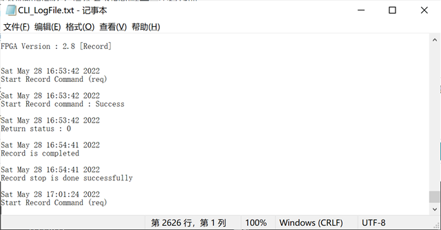

我们团队最近在做心电监护,需要知道毫米波雷达数据的时间戳来跟我们的心电仪器实现同步?
雷达波数据里没有时间戳,您是要自己添加时间戳么?请参考下面的帖子是否有帮助。
https://e2e.ti.com/support/sensors-group/sensors/f/sensors-forum/842511/iwr6843-output-datetime-stamping
mmwave studi的时间没法精确到ms级。请看下面帖子的讨论。
In the output console of mmwave studio, a time stamp is shown but not to the accuracy of mSec. It is not a supported feature to add timestamp using mmwave studio.
https://e2e.ti.com/support/sensors-group/sensors/f/sensors-forum/696125/awr1443boost-raw-adc-streaming-of-radar-samples-using-dca1000
