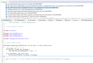

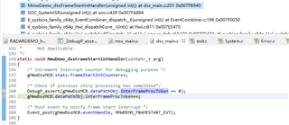

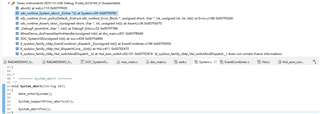

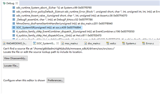

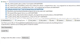

您好,我想问一下我自己编写了一点函数加入之后,运行就会中断,如下所示,不知道是为什么

consolo信息:
[Cortex_R4_0] **********************************************
Debug: Launching the Millimeter Wave Demo
Debug: MMWDemoMSS Launched the Initialization Task
Debug: MMWDemoMSS mmWave Control Initialization was successful
Debug: CLI is operational
[C674X_0] Debug: Logging UART Instance @0080ee38 has been opened successfully
Debug: DSS Mailbox Handle @00805d28
Debug: MMWDemoDSS create event handle succeeded
Debug: MMWDemoDSS mmWave Control Initialization succeeded
Debug: MMWDemoDSS ADCBUF Instance(0) @0080ee20 has been opened successfully
Debug: MMWDemoDSS Data Path init succeeded
Debug: MMWDemoDSS initTask exit
[Cortex_R4_0] numRangeBinZoomIn=2,left=0,right=0
enableRangeLimit=1,skipMin=1.000000,skipMax=3.000000
Debug: MMWDemoMSS Received CLI sensorStart Event
Debug: System Heap (TCM): Size: 65536, Used = 33280, Free = 32256 bytes
Debug: MMWDemoMSS mmWave config succeeded
[C674X_0] DSS:enableRangeLimit=1,skipMin=1.00,skipMax=3.00,rangeResolution=0.0435,skipLeft=23,skipRight=443
DDR Heap : size 65536 (0x10000), used 8240 (0x2030)
LL2 Heap : size 20480 (0x5000), used 16564 (0x40b4)
LL2 Scratch : size 8192 (0x2000), used 8192 (0x2000)
LL1 Scratch : size 16384 (0x4000), used 4096 (0x1000)
HSRAM Heap : size 8192 (0x2000), used 0 (0x0)
{module#8}: "../dss_main.c", line 200: error {id:0x10000, args:[0x80dacc, 0x80dacc]}
xdc.runtime.Error.raise: terminating execution
[Cortex_R4_0] xdc.runtime.Main: "../mss_main.c", line 973: assertion failure
