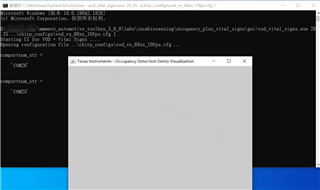

When i try to use the vod_vital_signs Gui with cmd after connected COM port and changed it to my right number, it was open the window as shown in picture,but it don't shown anything

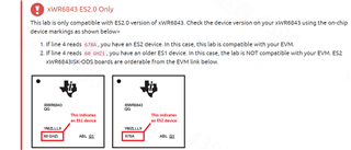

Thanks. I didn't find witch is 'OOB demo' refer to your link. But i tried 'overhead_mount_occupancy' demo,witch is not working well. Then i checked the overhead_VOD_user_guide, it indicates 'divice version' limit(as showm in picture).So i checked my IWR6843ISK EVM, it is '60 GHZi'( an older ES1 device).
Please confirm that whether ‘occupancy_plus_vital_signs’ demo has the same 'divice version' restriction with 'overhead_mount_occupancy' demo.

请贴出demo所在的具体toolbox版本,通常都可以在release note中查到适用的芯片版本。
toolbox/路径:mmwave_automotive_toolbox_3_6_0\labs\incabinsensing\occupancy_plus_vital_signs
release note 只说明了evm版本,没说divice version
查到了要求IWR6843ISK (Rev B)。我手中版本为Rev A.。谢谢。
