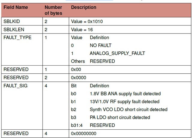

[Cortex_R4_0] Debug: Launched the Initialization Task
Debug: Initialized the mmWave module
Debug: Synchronized the mmWave module
Error: Asynchronous Event SB Id 16 not handled
由于这个错误是由TI的MRR_MSS_eventFxn函数打印,请问该如何解决呢?
