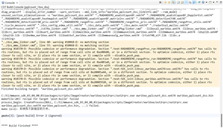

1.DSS编译报错
<Linking>
"../dss_mmw_linker.cmd", line 40: warning #10068-D: no matching section
"../dss_mmw_linker.cmd", line 55: warning #10068-D: no matching section
warning #10370-D: Possible codesize or performance degradation. Section ".text:RADARDEMO_rangeProc_run:RADARDEMO_rangeProc.oe674" has calls to rts routines, but rts is placed out of range from call site at 0xe00600, or in a different section. To optimize codesize, either 1) place rts closer to call site, or 2) place rts in same section, or 3) compile with --disable_push_pop.
warning #10370-D: Possible codesize or performance degradation. Section ".text:RADARDEMO_rangeProc_run:RADARDEMO_rangeProc.oe674" has calls to rts routines, but rts is placed out of range from call site at 0xe003a0, or in a different section. To optimize codesize, either 1) place rts closer to call site, or 2) place rts in same section, or 3) compile with --disable_push_pop.
warning #10370-D: Possible codesize or performance degradation. Section ".text:SOC_init:libsoc_xwr16xx.ae674<soc.oe674>" has calls to rts routines, but rts is placed out of range from call site at 0x20005a44, or in a different section. To optimize codesize, either 1) place rts closer to call site, or 2) place rts in same section, or 3) compile with --disable_push_pop.
warning #10370-D: Possible codesize or performance degradation. Section ".text:SOC_init:libsoc_xwr16xx.ae674<soc.oe674>" has calls to rts routines, but rts is placed out of range from call site at 0x20005920, or in a different section. To optimize codesize, either 1) place rts closer to call site, or 2) place rts in same section, or 3) compile with --disable_push_pop.
Finished building target: "xwr16xx_pplcount_dss.xe674"
C:/ti/mmwave_sdk_03_04_00_03/packages/scripts/ImageCreator/xwr16xx/out2rprc/out2rprc.exe xwr16xx_pplcount_dss.xe674 xwr16xx_pplcount_dss.bin
makefile:203: recipe for target 'post-build' failed
process_begin: CreateProcess(NULL, C:/ti/mmwave_sdk_03_04_00_03/packages/scripts/ImageCreator/xwr16xx/out2rprc/out2rprc.exe xwr16xx_pplcount_dss.xe674 xwr16xx_pplcount_dss.bin, ...) failed.
make (e=2): 系统找不到指定的文件。
gmake[3]: [post-build] Error 2 (ignored)
**** Build Finished ****

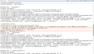

2.mss编译报错
Finished building: "../gtrackAlloc.c"
Building file: "../mss_main.c"
Invoking: Arm Compiler
"C:/ti/ti-cgt-arm_16.9.6.LTS/bin/armcl" -mv7R4 --code_state=16 --float_support=VFPv3D16 -me -O3 --include_path="C:/ti/ccsproject/pplcount_16xx_mss" --include_path="C:/ti/mmwave_sdk_03_04_00_03" --include_path="C:/ti/mmwave_sdk_03_04_00_03/packages" --include_path="C:/ti/mmwave/install/mmwave_industrial_toolbox_4_0_1/labs/people_counting/16xx_people_counting/pjt/radarDemo" --include_path="C:/ti/mmwave/install/mmwave_industrial_toolbox_4_0_1/labs/people_counting/16xx_people_counting/pjt/radarDemo/chains/RadarReceiverPeopleCounting/mmw_PCDemo/gtrack" --include_path="C:/ti/ti-cgt-arm_16.9.6.LTS/include" --define=SOC_XWR16XX --define=SUBSYS_MSS --define=DOWNLOAD_FROM_CCS --define=DebugP_ASSERT_ENABLED --define=_LITTLE_ENDIAN --define=MMWAVE_L3RAM_SIZE=0x40000 -g --c99 --diag_warning=225 --diag_wrap=off --display_error_number --gen_func_subsections=on --enum_type=int --abi=eabi --obj_extension=.oer4f --preproc_with_compile --preproc_dependency="mss_main.d_raw" --cmd_file="configPkg/compiler.opt"  "../mss_main.c"
>> Compilation failure
subdir_rules.mk:9: recipe for target 'mss_main.oer4f' failed
"../mss_main.c", line 407: warning #169-D: argument of type "int32_t *" is incompatible with parameter of type "MMWave_CalibrationData *"
"../mss_main.c", line 407: error #167: too few arguments in function call
1 error detected in the compilation of "../mss_main.c".
gmake[1]: *** [mss_main.oer4f] Error 1
