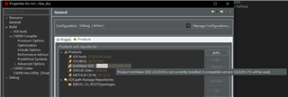

Rebuild mrr_18xx_dss 會產生以下 Warnings,Console如文最後的 CDT Build Console mrr_18xx_dss.txt
#10068-D no matching section
#10370-D Possible codesize or performance degradation. Section ".text:SOC_init:libsoc_xwr18xx.ae674<soc.oe674>" has calls to rts routines, but rts is placed out of range from call site at 0x20002460, or in a different section. To optimize codesize, either 1) place rts closer to call site, or 2) place rts in same section, or 3) compile with --disable_push_pop.
#10370-D Possible codesize or performance degradation. Section ".text:SOC_init:libsoc_xwr18xx.ae674<soc.oe674>" has calls to rts routines, but rts is placed out of range from call site at 0x20002590, or in a different section. To optimize codesize, either 1) place rts closer to call site, or 2) place rts in same section, or 3) compile with --disable_push_pop.
#9-D nested comment is not allowed
Product mmWave SDK v3.2.0.04 is not currently installed. A compatible version 3.6.0.00-LTS will be used.
