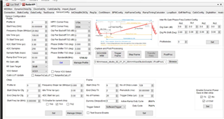

我使用的设备是IWR6843AOPEVM Rev G + DCA1000EVM 捕获原始的ADC数据
数据捕获过程中能够正常使用 但是少了一半的帧
正常捕获后的数据大小为 4 x 3 x 128 x 256 x Frames x 4bits
我捕获的ADC数据大小会小一半
调用rawDataReader.m 验证也是只有一半的帧(No of Freams 为25
每帧里面数据格式正常
附上xx.mmwave.json文件

and adc_data_LogFile.txt
19-Sep-2022 16:45:57: IsFPGA:,0,0,
19-Sep-2022 16:45:57: C:\ti\mmwave_studio_02_01_01_00\mmWaveStudio\RunTime,0,
19-Sep-2022 16:45:59: API:select_capture_device,DCA1000,0,
19-Sep-2022 16:46:19: API:select_chip_version,IWR6843,0,
19-Sep-2022 16:46:41: API:ChannelConfig,7,15,0,
19-Sep-2022 16:46:41: API:AdcOutConfig,2,1,0,
19-Sep-2022 16:46:41: API:DataFmtConfig,15,2,1,0,1,0,
19-Sep-2022 16:46:42: API:LowPowerConfig,0,0,0,
19-Sep-2022 16:46:45: API:DataPathConfig,1,1,0,2,0,
19-Sep-2022 16:46:46: API:LvdsClkConfig,1,1,0,
19-Sep-2022 16:46:46: TSW1400 Sampling rate : 600000000 7500000,0,
19-Sep-2022 16:46:46: API:SetHsiClock,9,0,
19-Sep-2022 16:46:47: API:LaneConfig,15,0,
19-Sep-2022 16:46:47: API:LvdsLaneConfig,0,1,0,
19-Sep-2022 16:46:48: API:ProfileConfig,0,1491308089,10000,600,6000,0,0,828,0,256,10000,0,0,30,0,
19-Sep-2022 16:46:48: API:ChirpConfig,0,0,0,0,0,0,0,1,0,
19-Sep-2022 16:46:48: API:ChirpConfig,1,1,0,0,0,0,0,4,0,
19-Sep-2022 16:46:48: API:ChirpConfig,2,2,0,0,0,0,0,2,0,
19-Sep-2022 16:46:50: API:EnableTestSource,0,1,0,
19-Sep-2022 16:46:50: API:FrameConfig,0,2,10,128,20000000,0,512,0,
19-Sep-2022 16:46:50: API:AdvancedFrameConfig,1,0,0,0,3,128,20000000,0,1,1,20000000,0,0,0,0,0,0,0,0,0,0,0,0,0,0,0,0,0,0,0,0,0,0,0,0,0,0,0,10,0,0,0,0,0,0,0,0,0,0,0,0,0,0,0,0,
19-Sep-2022 16:46:52: API:select_capture_device,DCA1000,0,
19-Sep-2022 16:46:57: API:SensorStart,0,
19-Sep-2022 16:47:02: API:update_num_adc_files_and_frames,1,10,1,0,
19-Sep-2022 17:07:01: API:update_num_adc_files_and_frames,1,10,1,0,
19-Sep-2022 17:07:59: The logfile name is ,0,0,0,
and adc_data_raw_logfile.csv
Start record configuration :
Log mode : Raw
LVDS lane mode : 2 lane
Record stop mode : Infinite
Max file size (MB) : 1024
Raw Data :
Out of sequence count - 0
Out of sequence seen from 0 to 0
First Packet ID - 1
Last Packet ID - 13504
Number of received packets - 13504
Number of zero filled packets - 0
Number of zero filled bytes - 0
Capture start time - Tue Sep 20 10:36:49 2022
Capture end time - Tue Sep 20 10:36:53 2022
Duration(sec) - 4
捕获完数据后为提示一个这个信息:(我设置成4帧 也只是只有一半
no of files captured:1,total no of frames for each device:4
