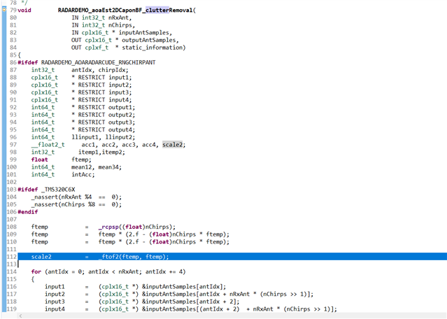

你好,我在这个相关帖子种看到你贴出的代码再取静杂波的时候,你求和完成之后,会除以chirp以获得平均值,但是我在该代码中未找到该操作,请问可以提供一下位置吗?

I suggest using the 4.12 toolbox because it is the most up to date.
The division happens on line 112 of the file listed. It's been removed in the version posted above, but in the original file it reads:
scale2 = _ftof2(ftemp, ftemp);
