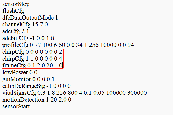

AWR1843BOOST: 我在使用呼吸心率测试demo的时候,更改了配置文件,就一直报错
Part Number: AWR1843BOOST
Other Parts Discussed in Thread: IWR6843
我使用的SDK版本为3.3.0.3
这个是配置文件
我想设置chirp分时发送,第一个用Tx2发射,第二个用Tx3发射,但是ccs调试模式下,一直报错,日志如下:
[C674X_0] Debug: MMWDemoDSS mmWave Control Initialization succeeded
[Cortex_R4_0] Debug: Launching the Vital-Signs Monitoring Demo
Debug: VitalSignsDemoMSS Launched the Initialization Task
Debug: VitalSignsDemoMSS mmWave Control Initialization was successful
Debug: CLI is operational
[C674X_0] Debug: MMWDemoDSS Data Path init succeeded
Debug: MMWDemoDSS initTask exit
[Cortex_R4_0] Sensor has been stopped
[C674X_0] Debug: Sending Vital Signs Configuration Message
[Cortex_R4_0] Debug: MMWDemoMSS Received CLI sensorStart Event
Debug: Sending rlRfSetLdoBypassConfig with 3 1 0
[C674X_0] {module#8}: "../dss/dss_main.c", line 2208: error {id:0x10000, args:[0x814474, 0x814474]}
xdc.runtime.Error.raise: terminating execution
"../dss/dss_main.c", line 2208的内容是:
之前设置了三发,所以配置了旁路电压。
想问下,我现在这个配置哪里有问题呀,为什么不可以运行
