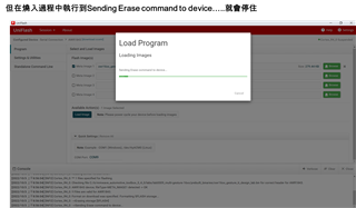

  使用UniFlash燒入  TI公版可以正常燒入,而自製開發版無法燒入,  燒入過程中執行到Sending Erase command to device…..就會停住

  燒入程式:ti\mmwave_automotive_toolbox_3_4_0\labs\lab0008_automated_parking\prebuilt_binaries\pa_18xx_mss_demo.bin

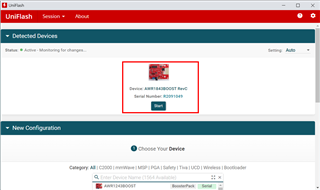

自製AWR1843BOOST可以讓uniflash抓取到板子相關資訊(下圖所示), SOP0-2 設定為101(下圖所示)
問題: 燒入過程會停在Sending Erase command to device…..,等待5min以上還是在此畫面,無相關錯誤訊息產生(下圖所示)
Console資訊:
[2022/10/6 下午3:17:08] [INFO] Cortex_R4_0: Initialization complete.
[2022/10/6 下午3:17:08] [INFO] Cortex_R4_0: Flashing process starting...
[2022/10/6 下午3:17:08] [INFO] Cortex_R4_0: Connecting to COM Port COM9...
[2022/10/6 下午3:17:08] [INFO] Cortex_R4_0: Reset connection to device
[2022/10/6 下午3:17:09] [INFO] Cortex_R4_0: Set break signal
[2022/10/6 下午3:17:09] [INFO] Cortex_R4_0: Connection to COM port succeeded. Flashing can proceed.
[2022/10/6 下午3:17:09] [INFO] Cortex_R4_0: Reading device version info...
[2022/10/6 下午3:17:09] [INFO] Cortex_R4_0: ** 1 files specified for flashing.
[2022/10/6 下午3:17:09] [INFO] Cortex_R4_0: Checking file C:/ti/mmwave_automotive_toolbox_3_4_0/labs/lab0009_multi-gesture-16xx/prebuilt_binaries/xwr16xx_gesture_ti_design_lab.bin for correct header for AWR1843.
[2022/10/6 下午3:17:09] [INFO] Cortex_R4_0: AWR1843 device, fileType=META_IMAGE1 detected -> OK
[2022/10/6 下午3:17:09] [INFO] Cortex_R4_0: !! Files are valid for AWR1843.
[2022/10/6 下午3:17:09] [INFO] Cortex_R4_0: Format on download was specified. Formatting SFLASH storage...
[2022/10/6 下午3:17:09] [INFO] Cortex_R4_0: -->Erasing storage [SFLASH]
[2022/10/6 下午3:17:09] [INFO] Cortex_R4_0: -->Sending Erase command to device...
