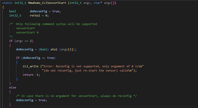

AWR2944EVM: 2944 sensorStart 0 Error
Part Number: AWR2944EVM
Other Parts Discussed in Thread: AWR2944
mmwDemo:/>sensorStart 0
sensorStart 0
Error: You have provided partial configuration between stop and this command and partial configuration cannot be undone.Issue the full configuration and do "sensorStart"
Error -1
