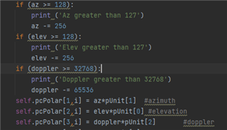

我按照之前介绍的操作对参数进行修改,保存后运行gui出现下面问题,请问如何解决!
Missed Frames 0/1000
Saved data file 0
Point Cloud TLV Parser Failed

请问只改了self.saveBinary 或self.saveTextFile其中一个参数吧?不要两个都置1。
请参考一下下面的帖子。
请问对oob_parser.py文件除了修改self.saveBinary参数,还有做其他修改吗?是用了Python 3.6 64 Bit这个版本么?

My sincerest apologies for the delayed response. I am unable to recreate this behavior on my end when following the same steps. However, please allow me until the end of this week to investigate this issue further. I will respond here on Friday at the latest.
BTW, could you explain the meaning of the code of the above snapshot?
This snippet of the visualizer's code is related to decompressing the compressed point cloud TLV. Please find more information regarding the compressed point cloud TLV in the 3D People Counting Demo User Guide.
