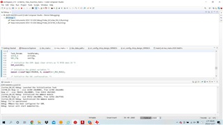

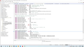

目前在嘗試修改Chirp參數,將ADC_SAMPLE_VAL由256增加為300. 我有同步進行相關參數修改如下圖,但實際運行後,在UI上看不到任何偵測物,想請問我的作法是否有錯,或是有哪些地方需再進行調整。

I would like you to confirm the following:
Error: mmWave Config failed [Error code: -3108 Subsystem: 41]
If so, you will have to make changes either to the sampling rate or the ramp end time to accommodate the 300 samples for the same chirp.
Additionally, I would kindly request the customer to migrate to the latest version of the automotive toolbox if possible.
