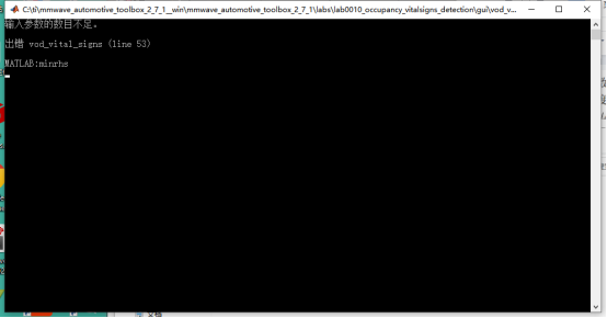

Occupancy & Vital Signs Detection例程gui界面打开出错,一直显示vod_vital_signs输入参数的数目不足,这是为什么,其他都配置好了呀
要在DOS下执行
Open a DOS Command Window, and cd to C:\lab00xx_occupancy_vitalsigns_detection\gui
At the DOS prompt, enter a command like this (based on the above arguments):
vod_vital_signs.exe DATA_COM_PORT APPLICATION/USER_COM_PORT ..\chirp_configs\vod_vital_signs_10fps.cfg 1 0
如
vod_vital_signs.exe 3 4 ..\chirp_configs\vod_vital_signs_10fps.cfg 1 0
在labs\lab0010_occupancy_vitalsigns_detection\docs\Occupancy_VitalSigns_Detection_User_Guide.pdf文档里有说明。
