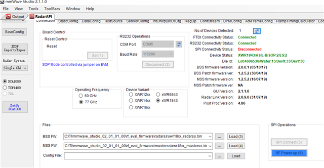

AWR1843BOOST: 和cda1000evm一块使用时,在mmwave studio GUI中连接spi不成功
Part Number: AWR1843BOOST
log信息显示如下,采用5V,3A电源输入,在uinflash中擦除了flash,s2开关也显示向spi方向,设置的是sop mode2,但是spi连接不成功,另一套一样的设备,一样的操作,显示spi连接成功,会不会是我的硬件问题。

[16:07:04] [RadarAPI]: Opening Gpio Control Port()
[16:07:04] Status: Failed to open/close GpioControl, Error Type: PROTOCOL ERROR
[16:07:04] [RadarAPI]: Opening Board Control Port()
[16:07:04] [RadarAPI]: Status: Failed to open/close BoardControl, Error value: -1
[16:07:05] [RadarAPI]: ar1.FullReset()
[16:07:05] [RadarAPI]: Status: Failed To give full reset, Error Value: -7
[16:07:06] [RadarAPI]: ar1.SOPControl(2)
[16:07:06] [RadarAPI]: Status: Passed
[16:07:12] [RadarAPI]: Opening Gpio Control Port()
[16:07:12] Status: Failed to open/close GpioControl, Error Type: PROTOCOL ERROR
[16:07:12] [RadarAPI]: Opening Board Control Port()
[16:07:12] [RadarAPI]: Status: Failed to open/close BoardControl, Error value: -1
[16:07:13] [RadarAPI]: ar1.FullReset()
[16:07:13] [RadarAPI]: Status: Failed To give full reset, Error Value: -7
[16:07:14] [RadarAPI]: ar1.SOPControl(2)
[16:07:14] [RadarAPI]: Status: Passed

[16:08:40] [RadarAPI]: ar1.PowerOn(0, 1000, 0, 0)
[16:08:40] Status: Failed, Error Type: RADAR INTERFACE ERROR
[16:08:45] MSS Power Up async event was not received!

[16:43:58] [RadarAPI]: ar1.PowerOn(0, 1000, 0, 0)
[16:43:58] Status: Failed, Error Type: RADAR INTERFACE ERROR
[16:44:02] MSS Power Up async event was not received!
  • 有可能是板子硬件的问题,请按照以下方式联系客户支持部门的技术部门,会有技术客服为您提供帮助。
    • 打开链接https://ticsc.service-now.com/csm
    • 点击申请新的支持下面的提交申请按钮
    • 在新打开的窗口中点击技术帮助下面的创建案例按钮
    • 在打开的表格中您可以使用中文描述您的问题并且递交。递交申请时,请您提及以下信息:
      • Ti.com购买订单号
      • 需要技术鉴定EVM是否存在质量问题
      • 您是否使用免费邮箱注册myti账号
