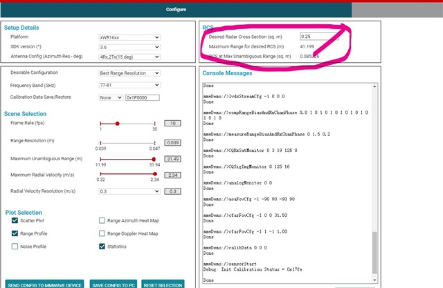

如题目,请问如何配置参数使得这个板子可以探测到80米左右的RCS 15-25cm大小的动物?

这个实现不了,请看下面的文档Table 1. Key System Specifications,
This represents the maximum distance that the radar can detect an object representing an RCS of approximately 10 m².
https://www.ti.com/lit/ug/tidud93/tidud93.pdf
目前没有。请看下面的文档表格Table 2-1. Object Versus Range大致了解距离和物体大小的检测范围。
https://www.ti.com/lit/an/swra593a/swra593a.pdf

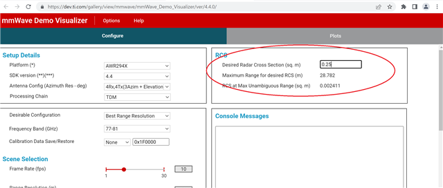

请看下面e2e工程师的回复。
The RCS of 15-25cm animal may directly not correspond to physical dimensions. This RCS would have to be determined experimentally.
Generally, an RCS of about 1m2 can be detected at 80m by AWR2944. Can you check the RCS value of the animal and compare it with 1m2? If it is greater, the animal can be detected by the mmwave device.
目前没有,您可以看一下下面mmwave demo visualizer GUI里的RCS参数调整
https://dev.ti.com/gallery/view/mmwave/mmWave_Demo_Visualizer/ver/4.4.0/
