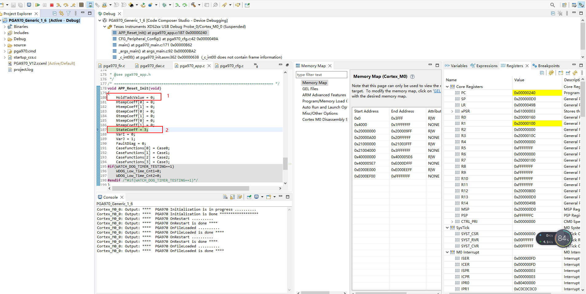

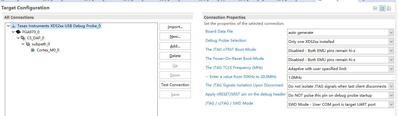

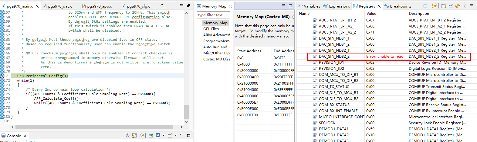

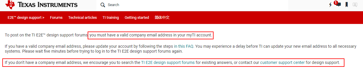

Kailyn, 我准备在E2E英文技术论坛上发布该问题,但是当我操作的时候,出现了下面的警告。我没有公司邮箱,只有个人邮箱,看起来是不能在英文版的论坛上提问。我已经将所有英文都添加了中文注释,并重新发布到中文论坛上,链接如下: https://e2echina.ti.com/support/sensors/f/sensors-forum/679821/pga970-ccs-step-into-dac_sin_nds2_2-demonx_data, 请帮忙解决问题!谢谢!
To post on the TI E2E If you have a valid company email address, please update your account by following the steps in this FAQ. You may experience a delay before TI can update your new email address to all necessary systems. Please wait five minutes before trying to log in to the TI E2E design support forums again. If you don't have a company email address, we encourage you to search the TI E2E design support forums for existing answers, or contact our customer support center for design support. |

您好,关于您的问题E2E已经给出答复:
关于这个问题,可能不能帮助到您这边太多,E2E给出了一个FAQ参考:
另外,您是否能否清除固件并查看是否可以从 DAC_SIN_NDSx 读取?
如果有其他问题,您直接在这里跟进就好。
