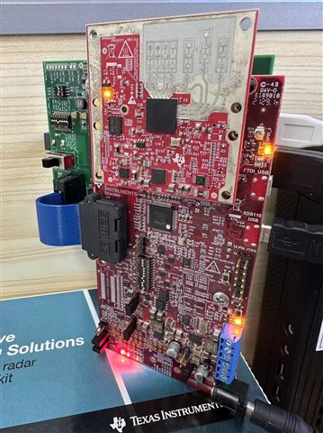

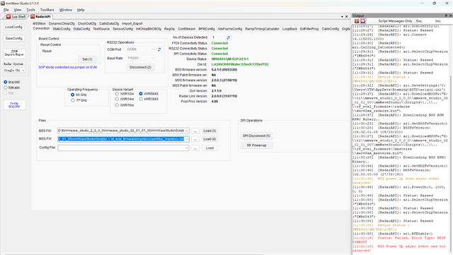

在使用DCA1000采集数据时,mmwave_studio 2.1.1.0版本下点击RF Power-up时报错,具体配置如下图:
实物连接图如下:
报错日志如下:
[11:29:25]  [RadarAPI]: Opening Gpio Control Port()
[11:29:25]  [RadarAPI]: Status: Passed
[11:29:25]  [RadarAPI]: Opening Board Control Port()
[11:29:26]  [RadarAPI]: ar1.FullReset()
[11:29:26]  [RadarAPI]: Status: Passed
[11:29:27]  [RadarAPI]: Closing Board Control Port()
[11:29:27]  [RadarAPI]: Status: Passed
[11:29:27]  [RadarAPI]: Closing Gpio Control Port()
[11:29:27]  [RadarAPI]: ar1.SOPControl(2)
[11:29:29]  [RadarAPI]: ar1.Connect(6,115200,1000)
[11:29:30]  [RadarAPI]: ar1.Calling_IsConnected()
[11:29:31]  [RadarAPI]: ar1.SelectChipVersion("IWR6843")
[11:29:31]  [RadarAPI]: Status: Passed
[11:29:32]  Device Status : IWR6843/QM/SOP:2/ES:1
[11:29:32]  [RadarAPI]: ar1.SaveSettings('C:\Users\YTM\AppData\Roaming\RSTD\ar1gui.ini')
[11:29:37]  [RadarAPI]: ar1.DownloadBSSFw("D:\\ti\\mmwave_studio_2_0_0_0\\mmwave_studio_02_01_01_00\\mmWaveStudio\\Scripts\\..\\..\\rf_eval_firmware\\radarss\\xwr68xx_radarss.bin")
[11:29:37]  [RadarAPI]: Downloading BSS ROM RPRC Binary..
[11:30:25]  [RadarAPI]: ar1.GetBSSFwVersion()
[11:30:25]  [RadarAPI]: BSSFwVersion:(06.02.01.05 (09/03/20))
[11:30:27]  [RadarAPI]: ar1.DownloadMSSFw("D:\\ti\\mmwave_studio_2_0_0_0\\mmwave_studio_02_01_01_00\\mmWaveStudio\\Scripts\\..\\..\\rf_eval_firmware\\masterss\\xwr68xx_masterss.bin")
[11:30:28]  [RadarAPI]: Downloading MSS RPRC Binary..
[11:30:46]  [RadarAPI]: ar1.GetMSSFwVersion()
[11:30:46]  [RadarAPI]: MSSFwVersion:(02.00.00.03 (27/08/19))
[11:30:49]  MSS power up done async event received!
[11:30:49]  [RadarAPI]: ar1.PowerOn(0, 1000, 0, 0)
[11:30:49]  [RadarAPI]: Status: Passed
[11:30:58]  [RadarAPI]: ar1.SelectChipVersion("IWR6843")
[11:30:58]  [RadarAPI]: Status: Passed
[11:30:58]  Device Status : IWR6843/QM/SOP:2/ES:1
[11:30:58]  [RadarAPI]: ar1.RfEnable()
[11:31:14]  Status: Failed, Error Type: RESP TIMEOUT
[11:31:18]  BSS Power Up async event was not received!
