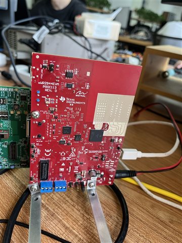

AWR2944EVM: AWR2944EVM REV.D connect dsp failed
Part Number: AWR2944EVM
Other Parts Discussed in Thread: UNIFLASH, AWR2944

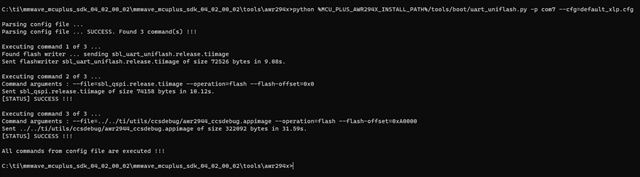

  1. in sop[2:0]=101  UART Boot ModeI use python script to download these three image: sbl_uart_uniflash.release.tiimage, sbl_qspi.release.tiimage, ti/utils/ccsdebug/awr2944_ccsdebug.appimage

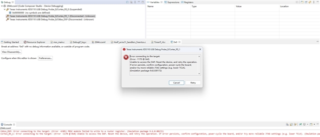

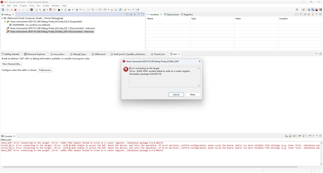

  2. in sop[2:0]=001  QSPI Boot Mode, I open Code Composer Studio,create a 2944.ccxml target configuration to debug myself app code, I can just connect cotex_R5_0,the other two core,I can not connect well.
So.my problem is that How to connect these core well and to debug myself app code.
    By the way, I changed the SDK to mmwave_mcuplus_sdk_04_03_00_01,and use the same way to flash images, I can connect coretex-r5_0 and dsp (not connect coretex-r5_1). When I use mmwave_mcuplus_sdk_04_02_00_02 ,I can just connect coretex-r5_0so please help me with this problem.
