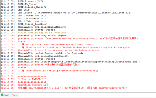

MMWCAS-DSP-EVM: MMWAVE-STUDIO安装问题
Expert 1815 points
Part Number: MMWCAS-DSP-EVM
  • 请问电脑操作系统是win7/win10吗?请看一下matlab是否安装32bit的?具体可以参考mmwave_studio_user_guide.pdf文档2.1 Installation
    2. Install 32-bit Matlab Runtime Engine (Version 8.5.1): It is used to run the PostProcessing utility within mmWaveStudio. in.mathworks.com/.../R2015 aSP1/installers/win32/MCR_R2015aSP1_win32_installer.exe NOTE: Please make sure the Matlab Runtime Engine installed is exactly same as 32-bit Version 8.5.1
