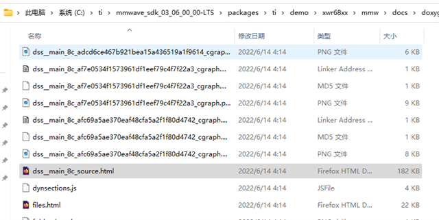

你好,请问iwr6843的SDK是否能看到源码?是否支持修改源码或者修改参数?能否自己设计?
您好,
以下是工程师的回复:All available source code in the SDK is located in <SDK_INSTALL_LOCATION>/source. Are you asking if we can support you making changes to the source code and whether we will do it? Or are you asking if it is possible for you to make these changes to the SDK? You are able to make whatever changes you want to the source code of the SDK, however, we cannot guarantee that it will work with your changes.

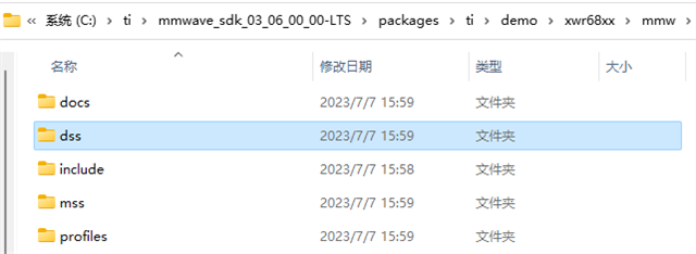

您好,
以下是工程师的回复:My apologies, I was looking at the LSDK and not the 3.6. To find the source code for the demos in SDK 3.6, simply navigate to the demo as you showed above, but instead of going to the docs folder, go to the mss and dss folders, which will contain the mss specific and dss specific files, respectively.
