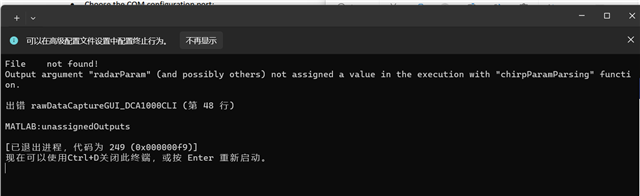

《User’s Guide for ADC Data Capture using OOB Demo and DCA1000EVM CLI application》根据这个文档做的测试,但是文档中3.2打开matlab这一步,根本打不开,右键管理员身份运行也不行,使用的DCA1000加IWR6843aopevm,电脑是window11系统。

readme.txt里有说明。
1. Prerequisites for Deployment
Verify that MATLAB Runtime(R2022b) is installed.
If not, you can run the MATLAB Runtime installer.
To find its location, enter
>>mcrinstaller
at the MATLAB prompt.
NOTE: You will need administrator rights to run the MATLAB Runtime installer.
Alternatively, download and install the Windows version of the MATLAB Runtime for R2022b
from the following link on the MathWorks website:
www.mathworks.com/.../index.html
For more information about the MATLAB Runtime and the MATLAB Runtime installer, see
"Distribute Applications" in the MATLAB Compiler documentation
in the MathWorks Documentation Center.
会出现这个错误,matlab runtime'2022b我没有安装在c盘会影响吗
readme.txt这个文档我就没找到 请问你是在哪里找到的
在C:\ti\radar_toolbox_1_20_00_11\tools\Adc_Data_Capture_Tool_DCA1000_CLI目录下
我安装的是默认路径。
电脑是window11系统。
建议用win10。我们很多软件只在win7/win10上测试过。
