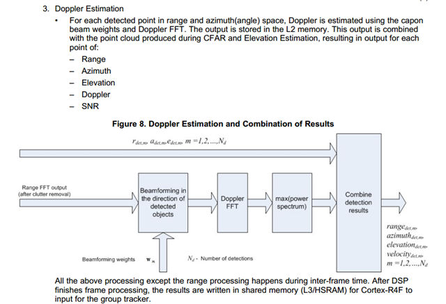

Dear TI engineers and other experts, thank you for your attention.
The Design Guide: TIDEP-01000 uses range-FFT, capon beamforming in azimuth dimension, elevation beamforming and doppler estimation to get the 4D information of objects. But I have some questions about the Doppler estimates. Consider a situation, the distance information of multiple points is the same, but their velocity information is different, which means that there will be multiple peaks in the RD spectrum obtained by Doppler FFT at the same distance bin. Correspondingly, RA spectrum also has multiple different orientation information at the same distance. I would like to ask how to solve the problem of matching the azimuth information with the speed information?
I am a beginner to FMCW mmWave radar and look forward to and appreciate the TI engineers and other experts taking the time to answer my questions.
