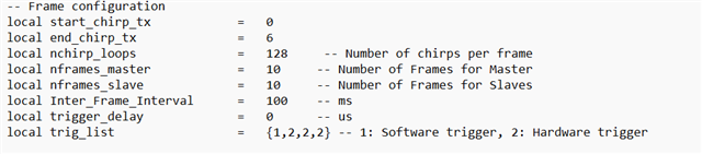

我看数据手册中应该有这个模式,我该修改哪个.lua脚本,并请告诉我该如何修改

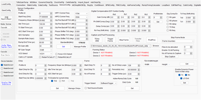

可以直接在GUI里选择哪块单芯片采集,请看下面的FAQ。
5. Can the 4-chip cascade board be used as a 2-chip board? If yes, what are the steps that need to be followed?
The user can select/unselect the number of devices to be used in mmwave studio. Click on “Setup TDAxx Capture Card” button in the left toolbar, and choose the number of devices you wish to enable.
In addition to this, if the user wants to reuse the example scripts provided with studio package, remember to edit them accordingly (as per device usage).
