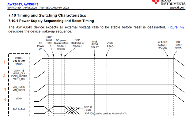

請問IWR6843 Power Supply Sequencing為何?
IWR6843  下面哪一組要先Turn ON,順序為何,時間為多少ms?
1.
VDDIN,
VIN_SRAM
2.
VIOIN_18
VIN18_CLK
VIOIN_18DIFF
VIN18_BB
3.
VIN_13RF1
VIN_13RF2
4.
VIOIN
