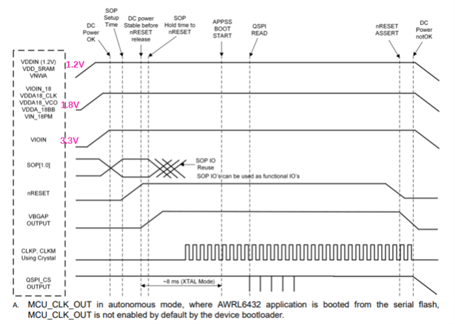

HI,
   Could you please inform me if there are strict requirements for the power-up voltage sequencing of AWRL6432? The power supply manufacturer I am consulting with requires matching its power-up sequence. I have only seen a diagram illustrating the power-up sequence in the specification sheet; if possible, please mark the detailed information on the diagram.
