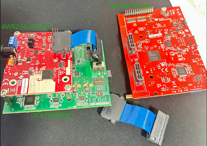

I’m currently working with AWR2243BOOST, TMDS273EVM, and DCA1000EVM, and I’d like to achieve the following:
  • Real-time visualization of point cloud data
  • Simultaneous capture and storage of raw ADC data
  1. Can AWR2243BOOST + TMDS273EVM alone perform both real-time point cloud visualization and raw ADC data capture at the same time?
  2. Is it possible to cascade TMDS273EVM and DCA1000EVM together with an AWR224BOOST board to achieve both functionalities?
  3. If cascading is not supported, can I use two AWR2243BOOST boards—one with DCA1000EVM for ADC capture and the other with TMDS273EVM for point cloud visualization?
  4. Is there any official Quick Start Guide for using AWR2243BOOST + TMDS273EVM? If not, could you please give a brief instruction on how I should connect them?
    [RR] No. The AM273x does not support the DCA1000EVM in any way. They are totally separate platforms.
    [RR] I don't see what would limit you being able to set up an AWR2243BOOST + DCA1000EVM and another, separate AWR2243BOOST + TMDS273EVM. Maybe I am not understanding your question though. The DCA1000EVM is intended for data capture and offline processing. The TMDS273EVM is intended to help develop realtime data processing.
