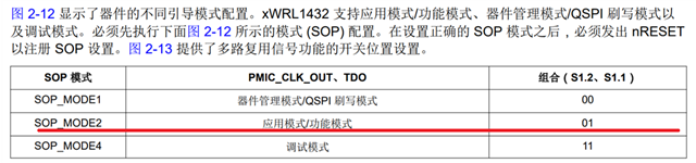

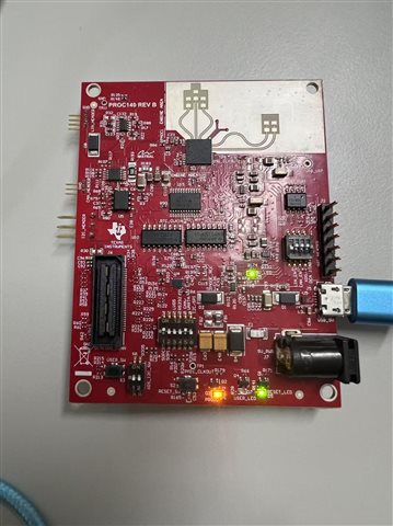

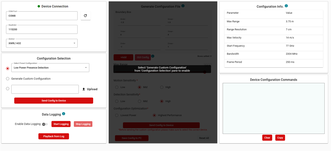

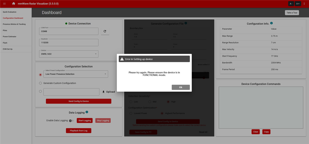

您好,我目前手頭有一個AWRL1432模組,無法進入functional mode,如下圖所示
並且已嘗試燒錄empty.bin進行CCS仿生器Debug仍然無法成功的進入偵錯模式,錯誤訊息如下:「Cortex_M4_0: Can't Run Target CPU: (Error -1268 @ 0x1090001) Device is locked up in Hard Fault or in NMI. Reset the device, and retry the operation. If error persists, confirm configuration, power-cycle the board, and/or try more reliable JTAG settings (e.g. lower TCLK). (Emulation package 9.12.0.00150)」,
