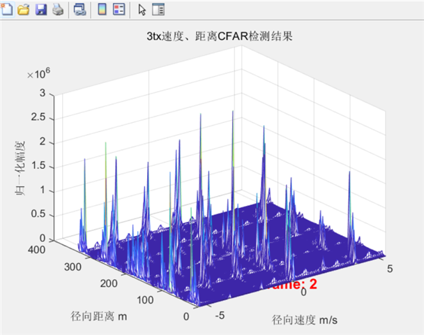

我在尝试使用四发四收的DDM模式来进行测量,以下为使用的配置,请问该配置下各个发射天线的相位差会是多少?
sensorStop
flushCfg
dfeDataOutputMode 1
channelCfg 15 15 0
adcCfg 2 0
adcbufCfg -1 1 0 0 1
lowPower 0 0
profileCfg 0 77 267 7 57.14 0 0 70 1 384 13349 0 0 158
chirpCfg 0 5 0 0 0 0 0 15
frameCfg 0 5 16 50 384 100 1 0
guiMonitor -1 2 1 0 0 0 1
cfarCfg -1 1 3 16 0 0 1 24.0 0 7 0 1
cfarCfg -1 0 3 16 0 0 1 15.0 0 7 0 1
compressionCfg -1 1 0 0.5 8
intfMitigCfg -1 15 18
localMaxCfg -1 6 40
ddmPhaseShiftAntOrder 0 2 3 1
antGeometryCfg 1 0 1 1 1 2 1 3 0 2 0 3 0 4 0 5 1 4 1 5 1 6 1 7 1 8 1 9 1 10 1 11 0.5 0.8
antennaCalibParams 0 1 0 1 0 1 0 1 0 1 0 1 0 1 0 1 0 1 0 1 0 1 0 1 0 1 0 1 0 1 0 1
measureRangeBiasAndRxChanPhase 0 1.5 0.2
analogMonitor 0 0
calibData 0 0 0
aoaFovCfg -1 -90 90 -90 90
lvdsStreamCfg -1 0 1 0
sensorStart
