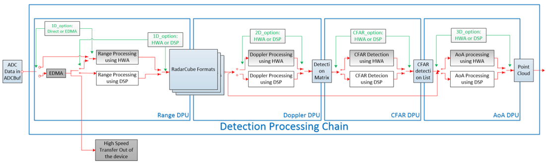

根据用户手册,xWR1843有DSP和HWA,那么根据SDK的data processing chain:
我们应该可以选择HWA或者DSP做信号处理。我查看了1843相关的demo project,发现基本都是采用HWA进行信号处理的,我这边希望知道如何将out-of-box demo的工程调整成采用dsp进行信号处理。请问我如何进行相关修改。

Hi
Medium Range Radar processing chain is implemented using DSP. If you are looking for OOB demo that uses DSP instead of HWA, you can refer to AWR1642 SDK demo and modify AWR1843 SDK demo accordingly.
