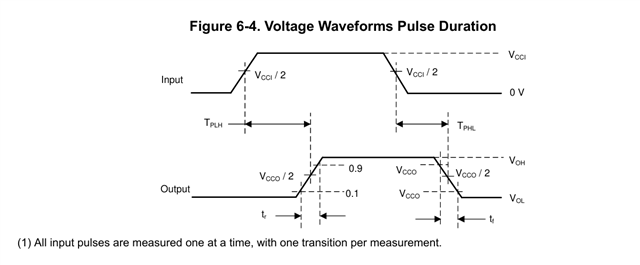

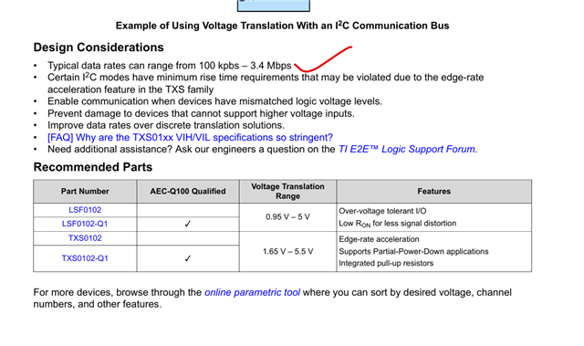

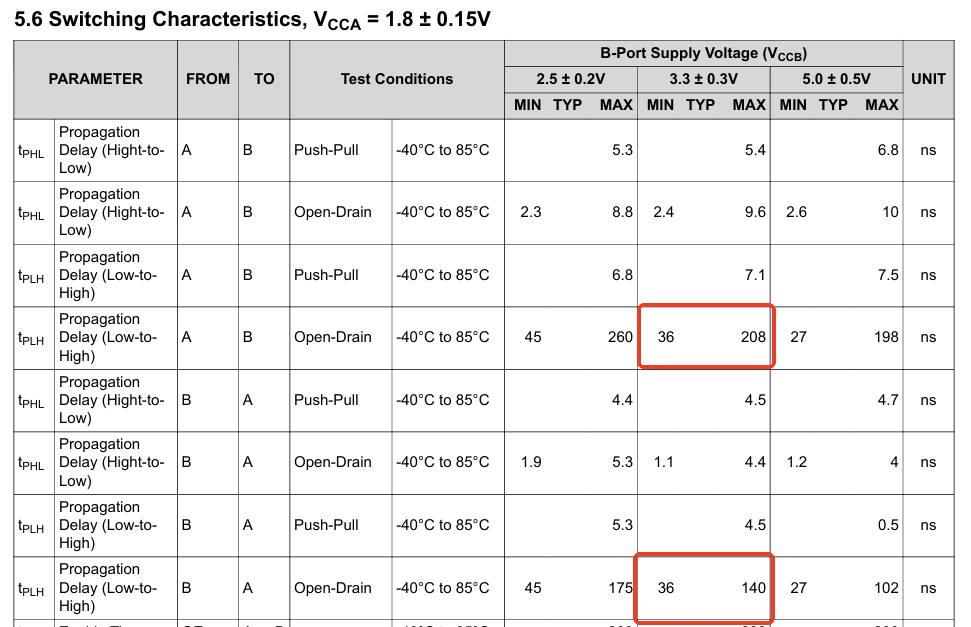

hi,everyone, I plan to use TXS0102DCUR to perform level conversion on the I2C signal with a rate of 400K, where VCCA is 1.8V and VCCB is 3.3V. According to the datasheet, the maximum propagation delay could reach 208ns. Considering that the data setup time requirement in the I2C standard is no less than 100ns, I am concerned that using TXS0102DCUR for level conversion might cause the I2C timing to fail to meet the requirements under certain extreme conditions. Could you please help analyze whether the TXS0102DCUR is suitable for the current usage scenario?  Thank you.
