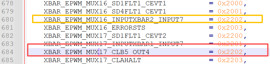

  I am a development engineer from China. There is a serious bug in your driverlib xbar.h, where different MUX configuration values are surprisingly the same. Specifically, it is on lines 680 and 684, and it has been three years without being corrected。e0641e58dcddacaec47487787ce57856.png
