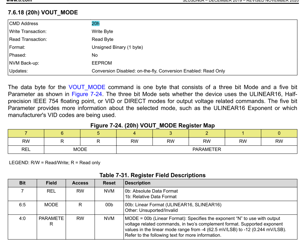

Hi TI experts,
We have one question for Vout_Mode of TPS546D24A(20h), we would like to know how to change the mode and is it related with external pin configurations? or something like firmware or component specificed.
Thanks.
Hi TI experts,
Thanks.
您好,
如table7-31所示,芯片上电后此寄存器的值除了MODE无法设置,其它是NVM中编程设置的值。
