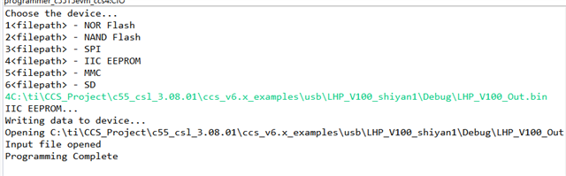

TMS320C5515: CSL_USB_MSC_dmaExample例程下载到开发板上无法运行
Part Number: TMS320C5515

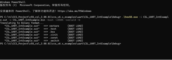

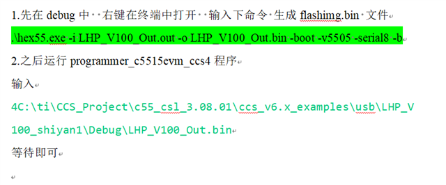

我将通过hex55.exe生成的CSL_USB_MSC_dmaExample_Out.bin文件通programmer_c5515evm_ccs4程序下载到以tms320c5515芯片为处理器的控制板上的IIC EEprom上程序无法按照逻辑运行,但是debug调试却可以正常运行。我还尝试了CSL_UART_IntExample例程,将这个例程的bin文件下载进去便可以正常运行。这是什么原因呢?下面是我尝试的两个例程链接
https://github.com/xuk5682-gif/USBMSC_DMAexample-UART_Intexample.git

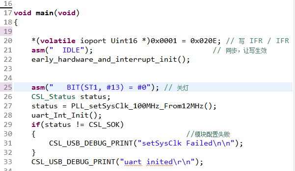

  •  我按照这个方法试了一下,但我还是没有成功。我的代码如下:
    void HWI_unused(void)
    /* minimal ISR stub: return immediately */
    asm(" NOP");
    return;
    void early_hardware_and_interrupt_init(void)
    /* 1) Configure ICR (address 0x0001) and execute IDLE to make configuration take effect */
    *(volatile ioport Uint16 *)0x0001 = 0x020E;
    asm(" idle");
    /* 2) Register HWI using BIOS API (Hwi_create). This preserves dispatcher behavior
    * equivalent to useDispatcher=1 in the .tcf configuration.
    /* Use DSP/BIOS HWI API to plug handlers and set per-HWI attributes
    * to match the .tcf configuration (ier0/ier1 masks).
    HWI_Attrs attrs;
    /* INT5 (vector 5) : mmcsd0_isr, IER0 mask 0x0020 */
    attrs = HWI_ATTRS;
    attrs.ier0mask = 0x0020;
    attrs.ier1mask = 0x0000;
    HWI_dispatchPlug(5, (Fxn)mmcsd0_isr, &attrs);
    /* INT7 (vector 7) : mmcsd0_isr, IER0 mask 0x0080 */
    attrs = HWI_ATTRS;
    attrs.ier0mask = 0x0080;
    HWI_dispatchPlug(7, (Fxn)mmcsd0_isr, &attrs);
    /* INT8 (vector 8) : dma_isr, IER0 mask 0x0100 */
    attrs = HWI_ATTRS;
    attrs.ier0mask = 0x0100;
    HWI_dispatchPlug(8, (Fxn)dma_isr, &attrs);
    /* INT9 (vector 9) : mmcsd0_isr, IER0 mask 0x0020 */
    attrs = HWI_ATTRS;
    HWI_dispatchPlug(9, (Fxn)mmcsd0_isr, &attrs);
    /* INT12: unused stub (keep default attrs) */
    attrs = HWI_ATTRS;
    HWI_dispatchPlug(12, (Fxn)HWI_unused, &attrs);
    /* INT20 (vector 20) : USB ISR, IER1 mask 0x0010 */
    attrs = HWI_ATTRS;
    attrs.ier0mask = 0x0000;
    attrs.ier1mask = 0x0010;
    HWI_dispatchPlug(20, (Fxn)USBisr, &attrs);
    /* 3) Clear IFR groups (clear pending flags) */
    CSL_CPU_REGS->IFR1 = 0x0;
    /* 4) Enable required IER bits (example: enable USB CPU interrupt) */
    CSL_FINST(CSL_CPU_REGS->IER1, CPU_IER1_RCV3, ENABLE);
    CSL_FINST(CSL_CPU_REGS->IER1, CPU_IER1_XMT3, ENABLE);
    CSL_FINST(CSL_CPU_REGS->IER1, CPU_IER1_USB, ENABLE);
    /* Note: enable additional IER bits for MMC/SD/DMA if required.
    * If using BIOS, consider using BIOS HWI_create instead of direct vector writes.
    }我把他们封装进了一个函数里,并在main.c的开头使用。

    main函数开头如下所示: 。我还是没有成功,您能帮我看看该如何配置吗?

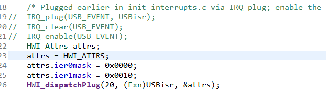

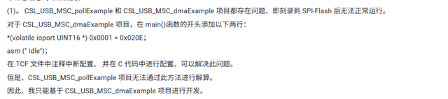

  • e2echina.ti.com/.../evm5515-csl_usb_msc_dmaexample_out-bin 我按照整个链接中的帖子进行尝试,代码如下:
    // /* Use DSP/BIOS HWI API to plug handlers and set per-HWI attributes
    // * to match the .tcf configuration (ier0/ier1 masks).
    HWI_Attrs attrs;
    // /* INT5 (vector 5) : mmcsd0_isr, IER0 mask 0x0020 */
    // attrs = HWI_ATTRS;
    // attrs.ier0mask = 0x0020;
    // attrs.ier1mask = 0x0000;
    // HWI_dispatchPlug(5, (Fxn)mmcsd0_isr, &attrs);
    // /* INT7 (vector 7) : mmcsd0_isr, IER0 mask 0x0080 */
    // attrs.ier0mask = 0x0080;
    // HWI_dispatchPlug(7, (Fxn)mmcsd0_isr, &attrs);
    // /* INT8 (vector 8) : dma_isr, IER0 mask 0x0100 */
    // attrs.ier0mask = 0x0100;
    // HWI_dispatchPlug(8, (Fxn)dma_isr, &attrs);
    // /* INT9 (vector 9) : mmcsd0_isr, IER0 mask 0x0020 */
    // HWI_dispatchPlug(9, (Fxn)mmcsd0_isr, &attrs);
    // /* INT12: unused stub (keep default attrs) */
    // HWI_dispatchPlug(12, (Fxn)HWI_unused, &attrs);
    attrs = HWI_ATTRS;
    /* Map MMCSD/PROG events to mmcsd0_isr */
    IRQ_plug(PROG0_EVENT, mmcsd0_isr);

    在CSL_Status configDmaforMmcSd(void)  函数中使能了dma。
    main函数如下:
    用hex55生成bin文件以及下载方式如下所示:
    但是依然没有启动成功,
    下载成功后,重新上电重启,代码无任何运行,指示灯也不灭。
  • 另外  usb中断的使能方式不知道为啥不能用// IRQ_plug(USB_EVENT, USBisr);
    // IRQ_clear(USB_EVENT);
    // IRQ_enable(USB_EVENT); 这几个函数使能,我用他们使能debug调试无法启动usb,总是显示设备无法识别,只有用
    HWI_Attrs attrs;
    attrs = HWI_ATTRS;
    HWI_dispatchPlug(20, (Fxn)USBisr, &attrs);这种方式,才能使pc识别usb并打开文件,这是什么原因?
  • 可否有这方面的专家帮我解答一下问题?
  • 那能否回答一下这个问题:另外  usb中断的使能方式不知道为啥不能用// IRQ_plug(USB_EVENT, USBisr);
    HWI_Attrs attrs;
    attrs = HWI_ATTRS;
