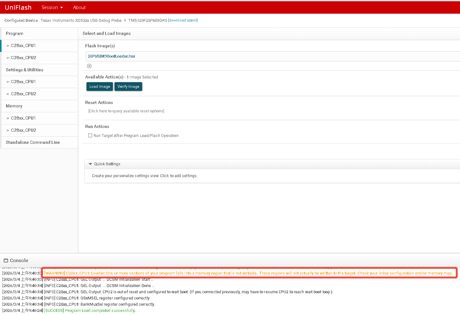

During the development process using the F28P65, the following warning appears when using Uniflash to program, pointing to a memory allocation issue.
However, after comparing with the datasheet, there are no non-compliant areas, and the program runs normally. Additionally, I only used CPU1. I am somewhat confused about this issue, so I hope to get some answers. Below is the text content of my CMD, hoping it can help in getting assistance:
