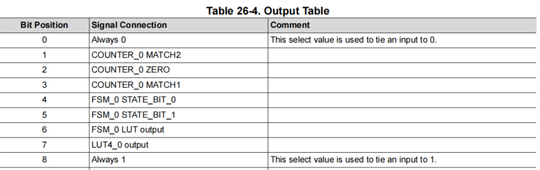

    CLB_disableCLB(CLB1_BASE);  // Force GLOBAL_EN = 0
    // Step 1: Configure counter input sources
    // The counter requires MODE_0 and MODE_1 to control counting
    // We want the counter to always count up, so MODE_0=1 (enable), MODE_1=1 (count up)
    // Select values from Table 26-4(from TRM (Technical Reference Manual) ):
    //   0x00 = Always 0
    //   0x08 = Always 1
    // CLB_selectCounterInputs() parameters are 32-bit, format:
    //   bits 4-0   = select value for unit 0
    //   bits 9-5   = select value for unit 1
    //   bits 14-10 = select value for unit 2
    // We only use unit 0; set unit 1/2 to 0
    uint32_t mode0 = (0x08 << 0) | (0x00 << 5) | (0x00 << 10);  // MODE_0 = Always 1
    uint32_t mode1 = (0x08 << 0) | (0x00 << 5) | (0x00 << 10);  // MODE_1 = Always 1
    uint32_t reset = 0x00000000;   // RESET = Always 0 (no reset)
    uint32_t event = (0x03 << 0) | (0x00 << 5) | (0x00 << 10);  // EVENT = MATCH1
    CLB_selectCounterInputs(CLB1_BASE, reset, event, mode0, mode1);

    // Step 4: Configure FSM0 input sources
    // FSM0's EXT_IN0 receives the counter's MATCH1 signal (to trigger state toggle)
    // Table 26-4: COUNTER_0 MATCH1 = 0x03
    uint32_t fsmExternal0 = (0x03 << 0) | (0x00 << 5) | (0x00 << 10);  // EXT_IN0 = MATCH1
    uint32_t fsmExternal1 = 0x00000000;   // EXT_IN1 = Always 0 (not used)
    uint32_t fsmExtra0 = 0x00000000;      // EXTRA_EXT_IN0 = Always 0 (not used)
    uint32_t fsmExtra1 = 0x00000000;      // EXTRA_EXT_IN1 = Always 0 (not used)
    CLB_selectFSMInputs(CLB1_BASE, fsmExternal0, fsmExternal1, fsmExtra0, fsmExtra1);

    // Step 7: Configure output LUT (3-input, for final output)
    // outputCfg format (32-bit):
    //   bits 4-0:   IN0 select value
    //   bits 9-5:   IN1 select value
    //   bits 14-10: IN2 select value
    //   bits 22-15: FN (8-bit truth table)
    // We use OUT13 (can connect to Output X-BAR)
    // IN0 = FSM_0 LUT output (Table 26-4: 0x06)
    // FN = 0xAA (8-bit: 1010 1010) meaning OUT = IN0
    uint32_t outputCfg = (0x06 << 0) | (0x00 << 5) | (0x00 << 10) | (0xAA << 15);
    // Configure OUT5 (OUTLUT5)
    CLB_configOutputLUT(CLB1_BASE, CLB_OUT5, outputCfg);
    // Enable OUT13 output
    CLB_setOutputMask(CLB1_BASE, CLB_OUTPUT_05, true);
    CLB_setOutputMask(CLB1_BASE, CLB_OUTPUT_13, true);

26.4.1 Static Switch Block
The Static Switch Block provides the configurable connectivity between the submodules in the CLB tile. The  outputs of all the submodules and the eight external inputs are connected to a common internal bus inside the  tile. Every input port has a 32-to-1 multiplexer and an associated 5-bit selection value that allows the user to  select one of the inputs on the bus. The only restrictions are certain signals (described below) that are tied off in  the design to prevent creation of accidental combinatorial loops.

  • Hi,
    While it is completely possible to use the CLB module without syscfg, we unfortunately do not have any examples showcasing how to do so.
    Syscfg does however generate the driverlib functions you are attempting to use. When configuring syscfg, this updates the driverlib functions and defines which can be found in the clb_config.h file.
    I believe it would be beneficial to look at the examples found within our C2000Ware SDK and taking a look at the driverlib functions that are called by syscfg.
