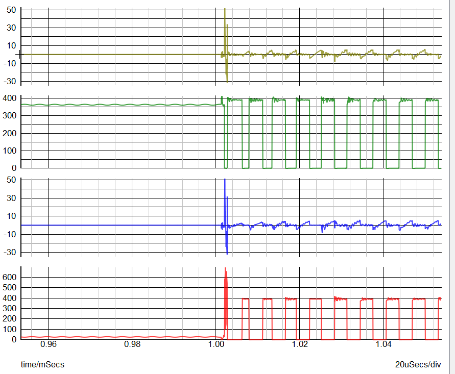

First, regarding MOSFET current and voltage spikes at startup: In simulation, when using MOSFET models, I observed large current and voltage spikes on the primary-side MOSFETs at the moment of startup. Adding a small amount of parasitic inductance does not eliminate these spikes. After reviewing relevant materials, I suspect the issue is caused by the MOSFETs' initial parasitic capacitance being zero and hard switching. Is there a solution for this?

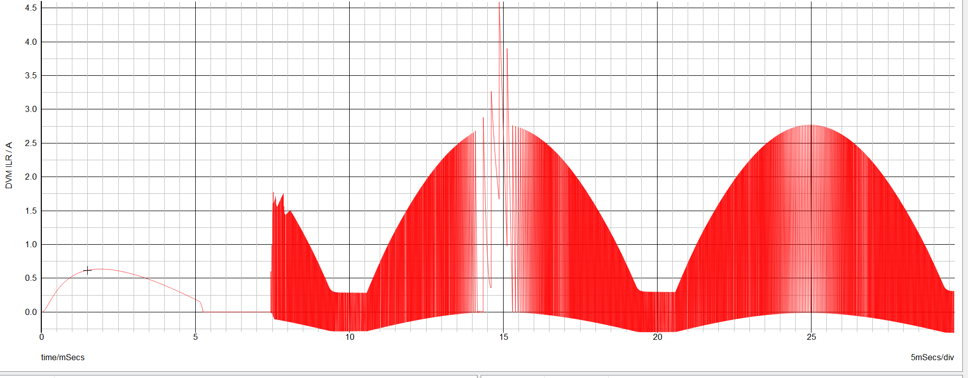

Third, regarding the UCC28056 startup issue: Sometimes, due to a small voltage difference during startup, the UCC28056 enters CCM mode, which creates an inductor current spike. How can this problem be resolved?
