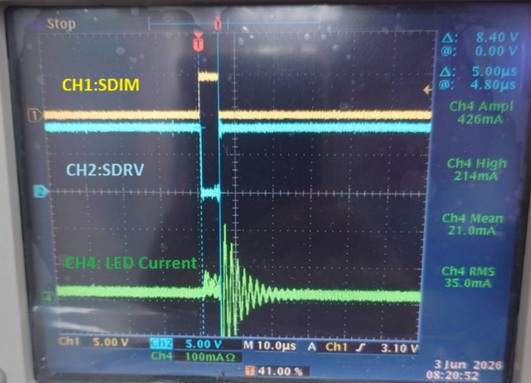

I am using the TPS92641EVM to conduct a LED shunt dimming test.
The test conditions and setup are as follows:
(1)Input Voltage: 43.5V,LED Load: 32V / 1A
(2)Connection: 10-meter cable is connected between the LED and the TPS92641EVM.
(3)SDIM Input: 100:1 PWM signal (f = 2 kHz)
(4)Shunt MOSFET: FKD4014 driven by the SDRV pin
Currently, I am unable to successfully achieve a target current pulse width of 5us at 200 mA.
Could you please help check my setup and advise on what modifications or adjustments are required to resolve this issue?
