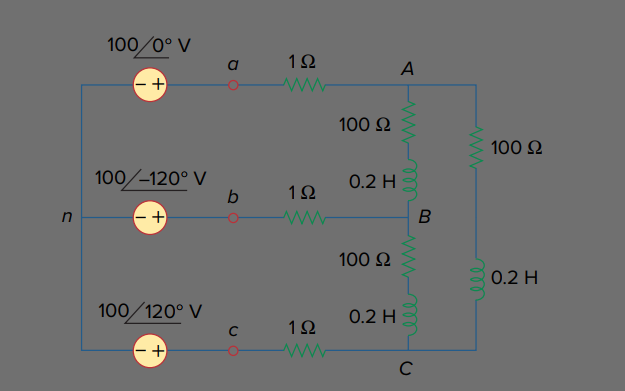

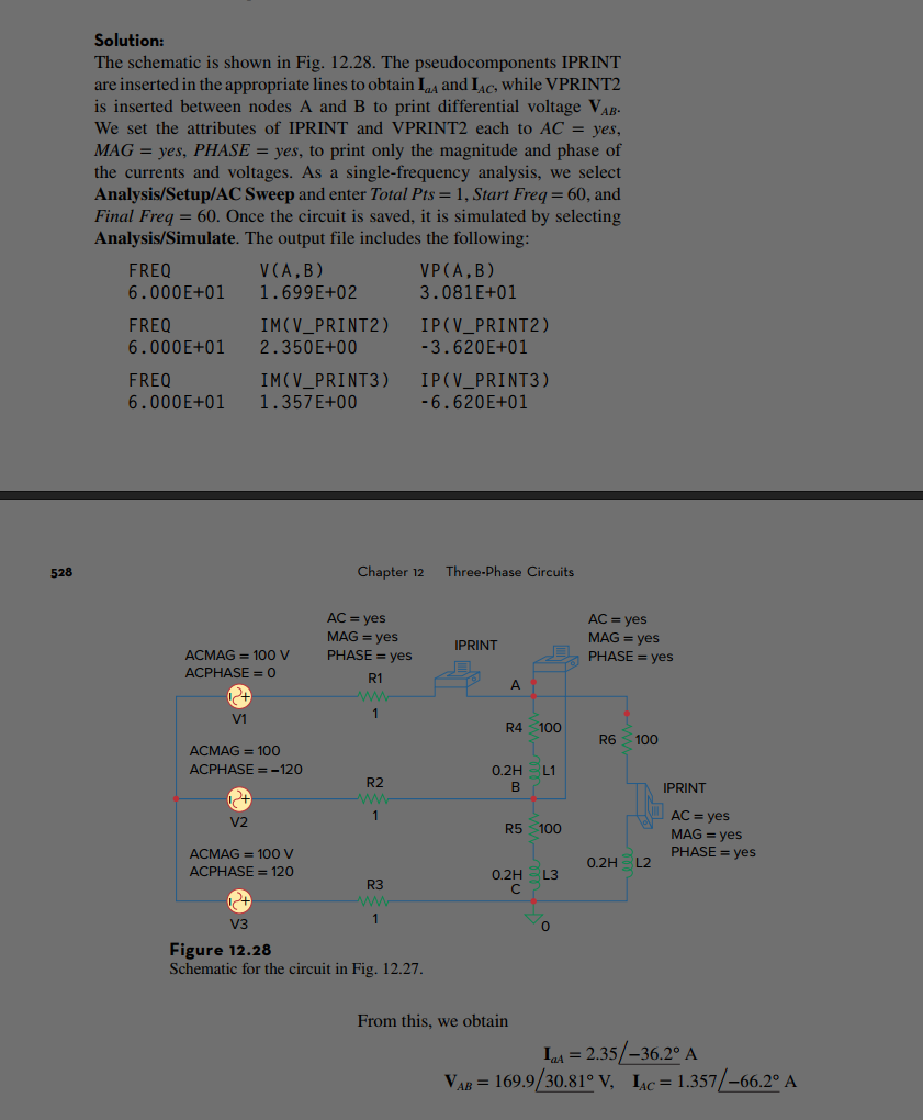

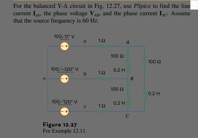

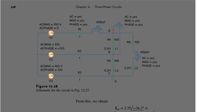

Q_book_chap12_9_1.rar
This is question from a book. I edit in Pspice and wish a solution like solution same as from book. where did I do wrong?
