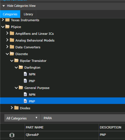

Hi,
1. 元件库中的非理想元件,比如下图中的三极管,如何查看它的相关参数?能否修改该参数?

  • 您好,
    1、请参考下面FAQ的步骤修改参数:
    https://e2e.ti.com/support/tools/simulation-hardware-system-design-tools-group/sim-hw-system-design/f/simulation-hardware-system-design-tools-forum/973740/faq-pspice-for-ti-can-i-define-my-own-model-in-pspice-for-ti/3596870?tisearch=e2e-sitesearch&keymatch=PSPICE%25252525252520for%25252525252520TI%25252525252520Modify%25252525252520the%25252525252520model%25252525252520parameters#3596870
