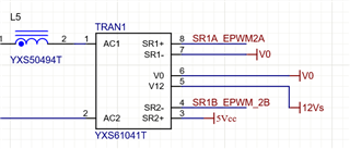

TIDA-010062: 请问LLC部分的变压器TRAN1是初级缠绕线圈 次级用PCB windings 吗?
Part Number: TIDA-010062
从PCB 上来看 变压器次级侧使用了PCB 线圈来代替绕线,初级侧是采用绕线的方式吗?
  • 次级:In the LLC transformer, there are four secondary PCB windings with an SR MOSFET and a dual-channel driver, connected in parallel, and three primary windings connected in serial. These windings are not connection joints, but all three use the same wire twisting.
